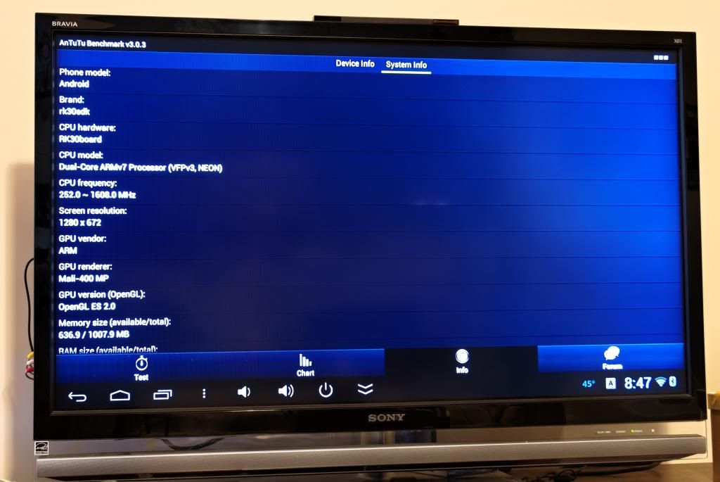

I would like to add that my MX1 is indeed running at 1.6ghz and not 1.2ghz. I purchased this MX1 last month and it came with the blue board and the bios from 29NOV. I also had the random crashing issue and narrowed it down to the scaling between the TV and the MX1. When I changed the display setting to 720p from 1080p, the reboots stopped completely. I am currently back at 1080p but I adjusted the scaling from the Sony TV and it has not crashed for 3 days. I'll report back if it reboots but so far so good. What I meant by scaling is, that HDMI port was originally hooked up to my PC where I needed to adjust the TV scaling so that the display would fill the entire screen. When I replaced the PC with the MX1 in that port, I didn't reset the setting from the TV but instead, I adjusted from within the MX1 display scaling setting. I don't think that agreed with the MX1 well, don't know if it is a MX1 bug or just not compatible with the TV but either way, I set the scaling back to the default setting and have been playing videos 3 days straight with no issues. I would upgrade to the 1080p bios to test that but all my PCs are running Windows 8 and the flashing software doesn't see the MX1 in Windows. So far, happy with the MX1.

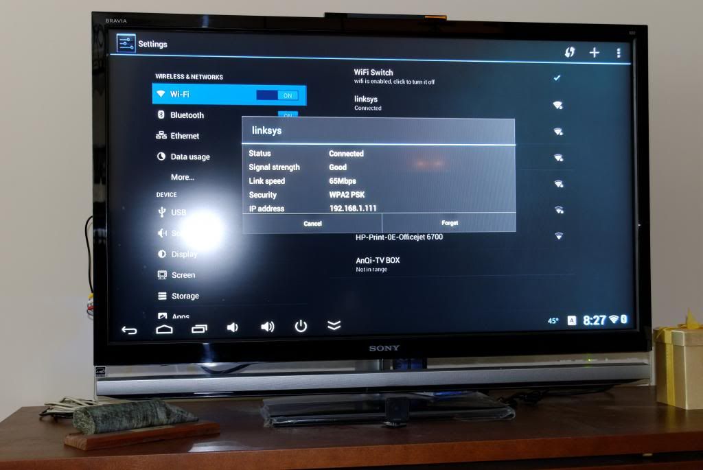

Pulled the Wifi antenna out to get good reception. The wifi router is an old one and is about 30 feet away in one of the bedrooms, the TV is in the living room.

n1smo wrote:I would like to add that my MX1 is indeed running at 1.6ghz and not 1.2ghz.
Could you test with CPU spy please?

I just ran CPU Spy and it is saying that the max usage was 1.2ghz. Disregard what I said earlier, guess I'm with everyone else.
